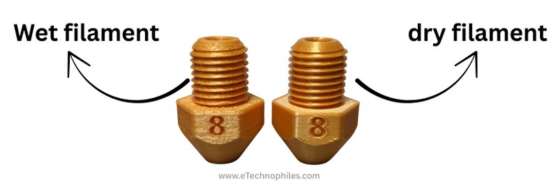

Why is a wet filament a problem?
Print Quality: Moisture in filament can drastically affect the print quality. When you heat the filament during printing, any trapped moisture turns into steam.
This steam creates bubbles or voids in the printed object, leading to pores in the structure. For instance, imagine your perfect design ending up with tiny holes, compromising its sturdiness and aesthetics.
Filament Strength: Wet filament doesn’t just ruin the aesthetics of a print; it weakens the 3d print too. Think about printing a tool handle with moisture-filled filament. The handle might break easily under pressure, making it a wasted print.
Smooth Extrusion: For a print to come out just right, the filament needs to flow smoothly. Moisture can disrupt this flow, leading to inconsistent extrusion. This inconsistency can result in uneven layers in your final product. Imagine aiming to print a sleek vase but ending up with a rough finish.
Signs of a wet filament
Hissing sound: If you hear a hissing sound during printing, it’s a clear sign of moisture in the filament. It’s the sound of moisture converting into steam due to heat and then escaping from the filament.
Rough Surface: A print that feels more like sandpaper than silk might be the result of wet filament. If you’re aiming for a smooth 3D print but it feels gritty, moisture might be the reason.
Stringing: Thin strings of filament connecting different parts of a print are one sign of moisture. For example, if you’re 3D Printing a miniature Eiffel Tower, but instead of clean lines, you get tiny filament strings crisscrossing.

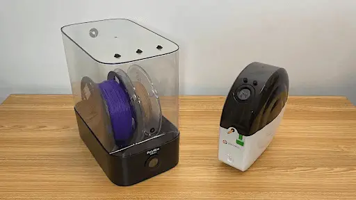

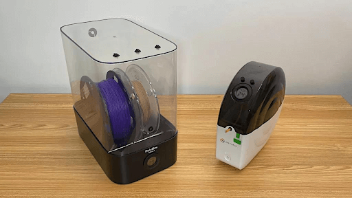

1. Filament Dryer: A filament dryer is a specialized device designed to dry 3D printing filaments. It works by heating the filament to a specific temperature, ensuring that any moisture in the filament is evaporated. Using a filament dryer is beneficial for hygroscopic materials like Nylon, PVA, or PETG, which tend to absorb moisture from the air.
| Material | Temperature (°C) | Drying Time (hours) |
| PLA | 45 | 4 |
| ABS | 60 | 2 |
| PETG | 65 | 3 |
| Nylon | 70 | 6 |
| PVA | 45 | 4 |
| TPU | 50 | 4 |
Note: The above temperatures and times are general recommendations. Always refer to the filament manufacturer’s guidelines for specific drying instructions.

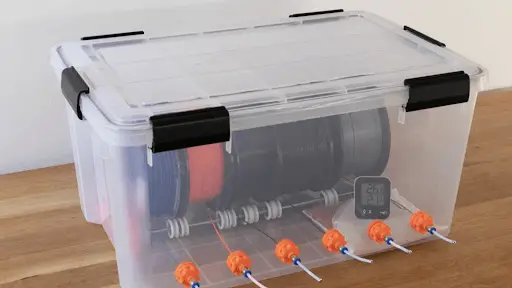

Preventive measures
Storage: Store your filament spools in a cool, dry place. Using sealed bags with desiccants is the best option to keep your filament moisture-free.

The easiest way to dry your 3d printing filaments is by using a filament dryer. The filament dryer is designed specifically for this purpose and can dry any filaments effectively at controlled temperatures. You can also use a food dehydrator to dry your filaments.
