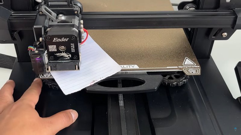

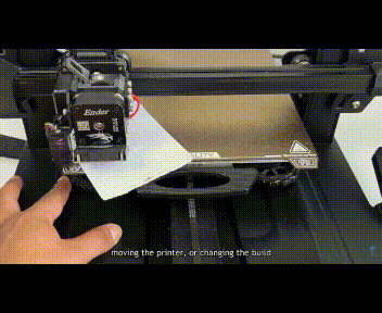

Move the nozzle to one corner of the bed and slide the paper between the nozzle and the bed.
Step 4: Adjust the bed knobs
Turn the heatbed knobs until the paper slides with light friction.
It should not move freely, and it should not get stuck.

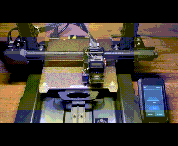

Step 1: Start the ABL process
Use “Level Bed,” “Mesh Bed Leveling,” or your printer’s equivalent option.
Step 2: Let the probe measure the bed
Follow any on-screen instructions. The probe will move around and check several points.
