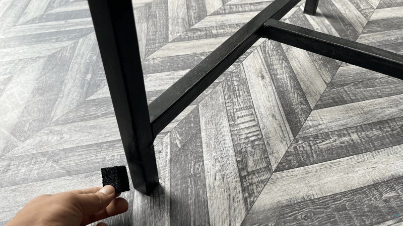

4. Placing the printer on an unstable surface
Once you’re done with the build, make sure your printer sits on a surface that’s completely flat and doesn’t wobble.
Even a slightly uneven table can produce a lot of unnecessary vibrations and noise. Sometimes it can also mess with your leveling and lead to poor first layers.
If you don’t have access to a better table, you can improve stability by adding rubber feet or placing foam pads underneath.

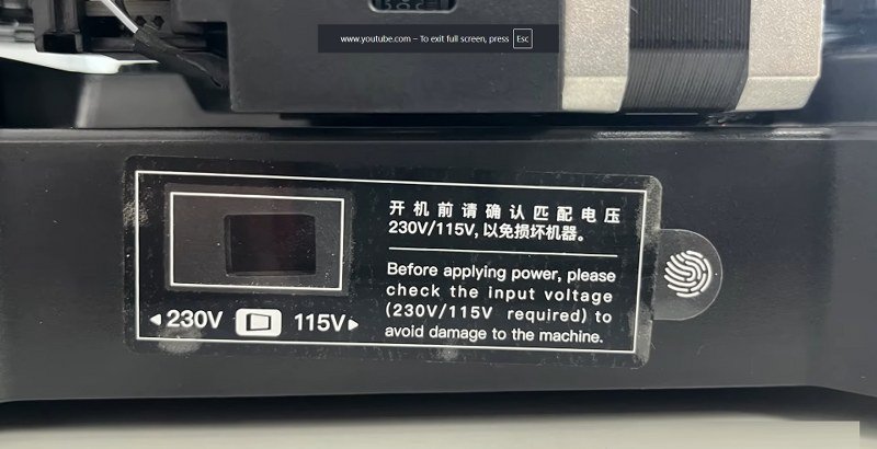

5. Not checking voltage settings
Before you switch on your printer for the first time, make sure it’s set to the correct voltage for your region.
Some printers, like the Ender 3 S1 Pro, have a little switch at the back that you need to flip manually. Getting this wrong can seriously affect the print quality.
That said, the most modern 3D printers, like the Bambu Lab A1, can detect this voltage difference automatically.

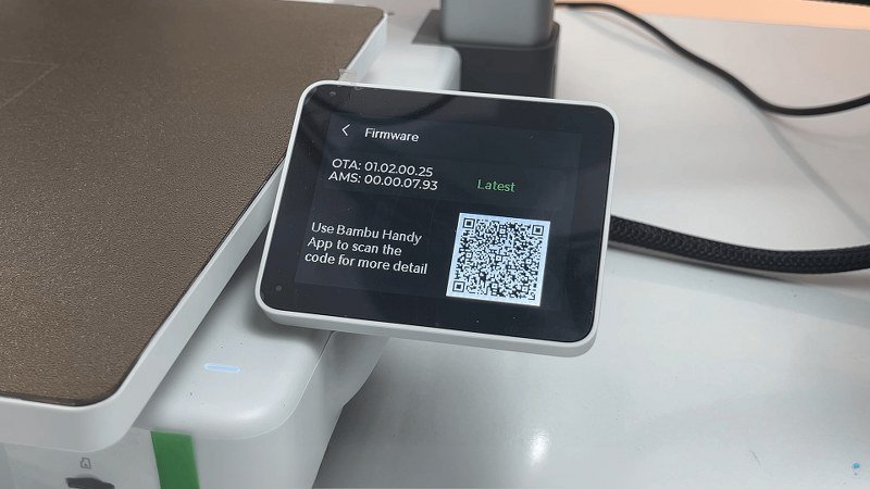

6. Don’t skip firmware updates
Some printers ship with outdated firmware — it’s more common than you’d think.
Updating it right away can fix hidden bugs, improve print quality, and sometimes even unlock features like better auto bed leveling or screen controls.
It only takes a few minutes, and it’s totally worth doing before your first real print.

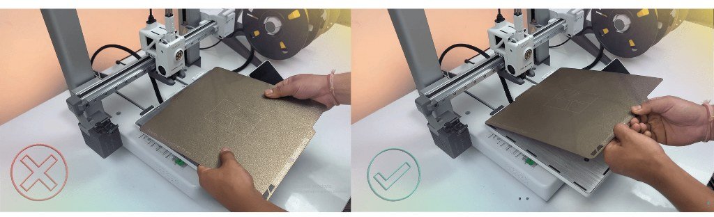

7. Touching the build plate surface
When placing or adjusting the build plate, avoid touching the print surface directly — always hold it from the edges.
Even clean hands leave behind oils and fingerprints, and that can mess with bed adhesion.
One smudge is all it takes for your first layer to lift or fail.

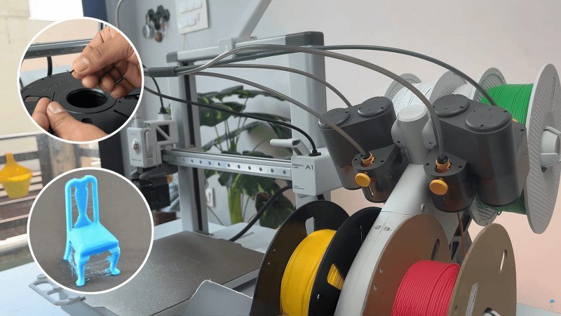

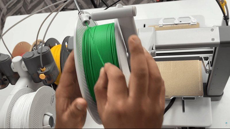

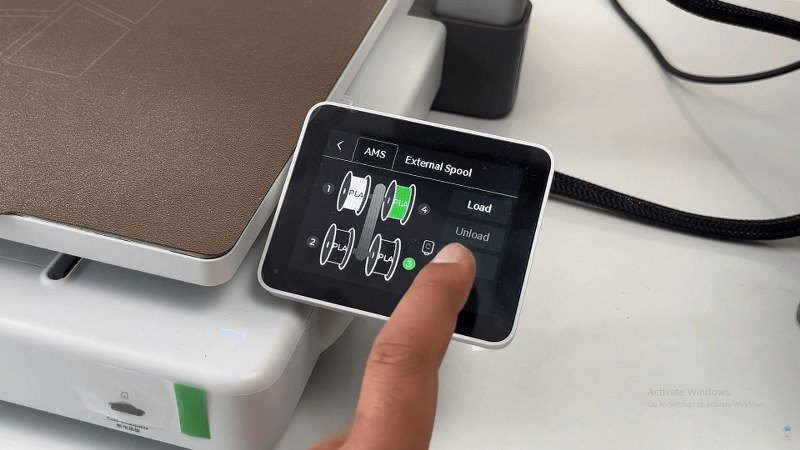

11. Wrong filament feed direction
When you’re getting ready to mount the filament spool for the first time, take a second to check which direction the filament should enter the extruder — from above or from below.
For example, with the external spool on the A1, the filament should enter from the top.
However, if you’re using the AMS for multicolor prints, the correct direction is from the bottom.
If it feeds from the wrong angle — especially from the top when it shouldn’t — it can cause extra tension, tangles, and even lead to filament breakage.

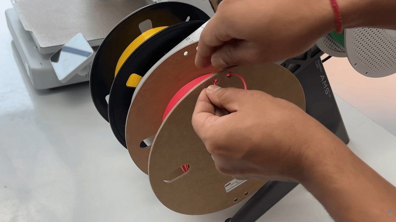

12. Not securing the filament after use
Whenever you’re done using a filament spool and tucking it away, make sure to insert the loose end or the tail of the filament into the hole or clip provided on the spool. If you don’t, the filament can slip under the other layers and get wedged.
And when you use it again, the extruder can pull too hard, creating tension, tangles, or even snapping the filament mid-print.

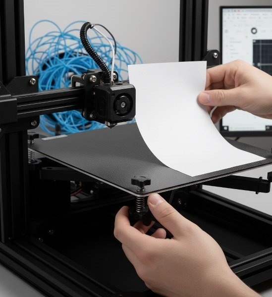

14. Ignoring bed leveling importance
Improper bed leveling is the number one reason for failed prints. It’s that important — and probably the most common issue faced by a beginner.
Luckily, there are tons of tutorials out there explaining common leveling mistakes and how to fix them — whether you’re using manual leveling, assisted leveling, or full-on automatic systems.
15. Over-relying on auto bed leveling
Auto bed leveling is awesome — no doubt. But it doesn’t mean your bed is magically perfect forever.
ABL compensates for minor unevenness, but it can’t fix things like a tilted X-axis, a warped bed, or a loose frame. You still need to manually level the bed once in a while, especially after assembly, moving the printer, or changing the build surface.
Not every printer is the same, so make sure to check how manual leveling works for your specific model.
16. Leveling the bed cold
Always level your bed after preheating — not while it’s cold. Why? Because the bed and metal parts expand slightly when heated, and that small change can throw off your leveling if you do it cold.
So before you level, preheat the bed to your usual printing temperature. You can preheat the nozzle as well for extra precision. Even before auto bed leveling begins, printers like the Bambu Lab A1 or Prusa MK4 automatically preheat the bed- and now you know why.
It might seem like a minor detail, but it makes a big difference for first-layer consistency.
An important point to note here: Make sure to unload the filament from the extruder before leveling, and manually extrude the remaining filament inside the nozzle. Then clean the nozzle so that no melted filament interferes with the leveling or throws off the Z-offset.

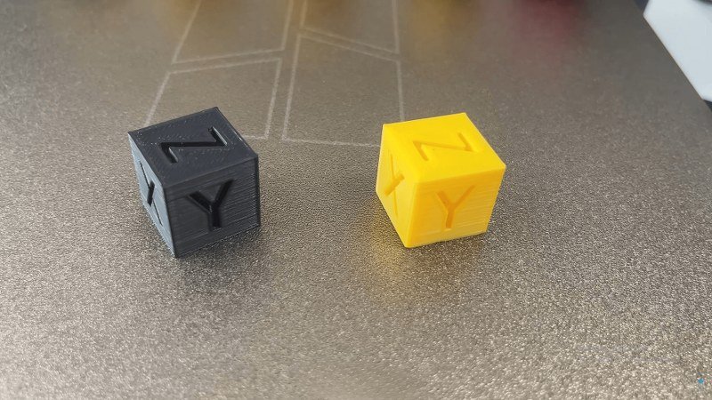

15. Jumping straight to big prints — run calibration tests first
I think everyone will agree with me on this — the first 3D printed model for most beginners is a Benchy. And yes, you should definitely print one on your new 3D printer, and it should be at the top of your list.
But here’s the thing: that one Benchy doesn’t tell you everything. It’s a good idea to run 2–3 different calibration prints before going for those big prints.
For example:
An XYZ calibration cube, or a tolerance/clearance test print. You could even go for a “torture toaster” to really push your printer’s limits.
These little guys help you dial in everything: how much plastic comes out (flow rate), how far the filament pulls back (retraction), and how well it handles weird angles (overhangs).
These small prints reveal hidden problems that a large print would waste hours and filament on. You’re better off fixing those issues early — not 10 hours into a failed print.

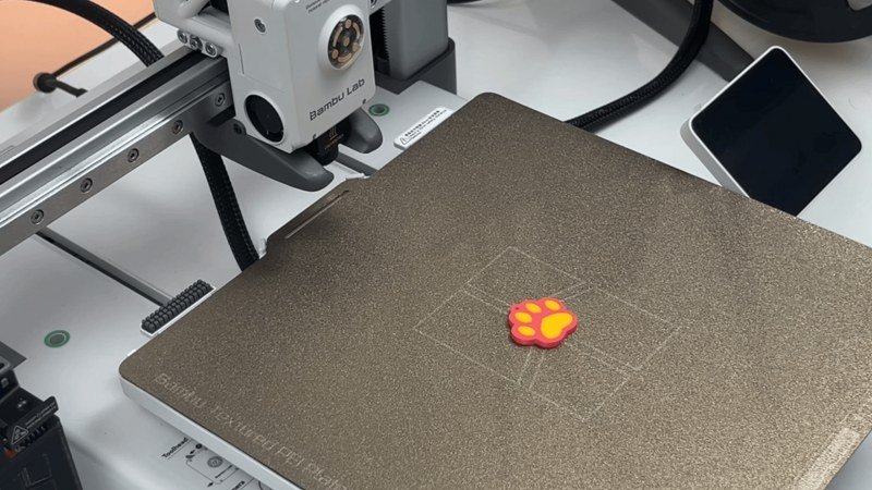

16. Always watch the first layer — every single time
The first layer is the foundation of your entire print — and most failures can be spotted right there. Whether it’s a big print or a small one, always stick around to watch the first layer go down.
If it’s not sticking, if it’s too squished or too high, you’ll know right away — and you can stop the print before wasting hours and filament. Leave it unattended too soon, and you might come back to a tangled mess of spaghetti or a nozzle dragging across the bed.
Trust me — watching that first layer saves you a lot of headaches.

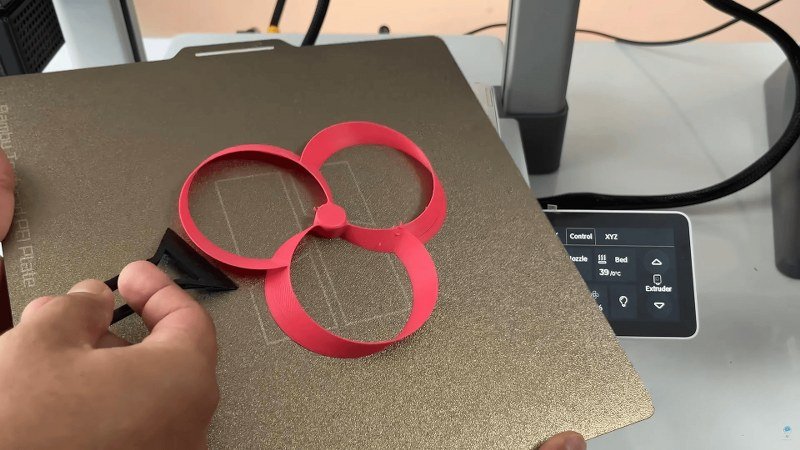

19. Removing prints too early
When your print finishes, resist the urge to pull it off the bed right away. Doing this can warp your part, misalign the plate, and even damage it. Let the build plate cool down completely first — as it cools, the print will naturally loosen from the surface, making removal easier and safer.
If your printer has a removable or flexible build plate, take it off before trying to remove the print. Now twist the plate, and it will come off.
If the print still won’t release easily, don’t force it with your hands — use a scraper.
Bonus tip: Avoid using a metal scraper as it can damage the build plate if you apply too much pressure. Use a plastic one instead… and guess what? You can 3D print as many as you want!

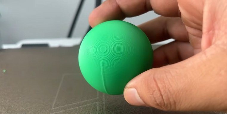

30. Printing complex models in one piece
Sometimes the best way to print a model… is to not print it all at once.
Take something like a sphere. If you try to print it as one solid piece, the bottom barely touches the bed, and it’ll probably need a brim and supports — and even then, the surface quality might not turn out great.

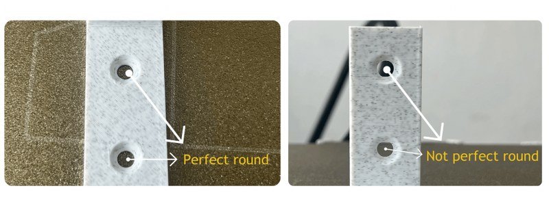

31. Incorrect orientation of holes
Here’s something most people don’t realize until it’s too late. If you print a circular hole vertically, it won’t come out perfectly round — it’ll usually be a little squished or rough due to how layers stack. To get cleaner results, design or orient your model so that circular holes print horizontally.
It’s a small change in design, but it makes a huge difference in how well things fit together later.
32. Design to minimize supports
Supports are helpful, but they’re not ideal — they use more filament, add cleanup time, and can mess up surface quality.
So when you’re designing a model, think about how to orient it to avoid supports as much as possible. Let’s say you’re designing a fence. If you model the pickets straight up, it’ll need tons of supports.
But if you rotate the whole thing and print it flat on its side, you can usually print it cleanly — no supports needed.
Always think ahead: “Can I design this in a way that prints better by default?” Most of the time, the answer is yes.

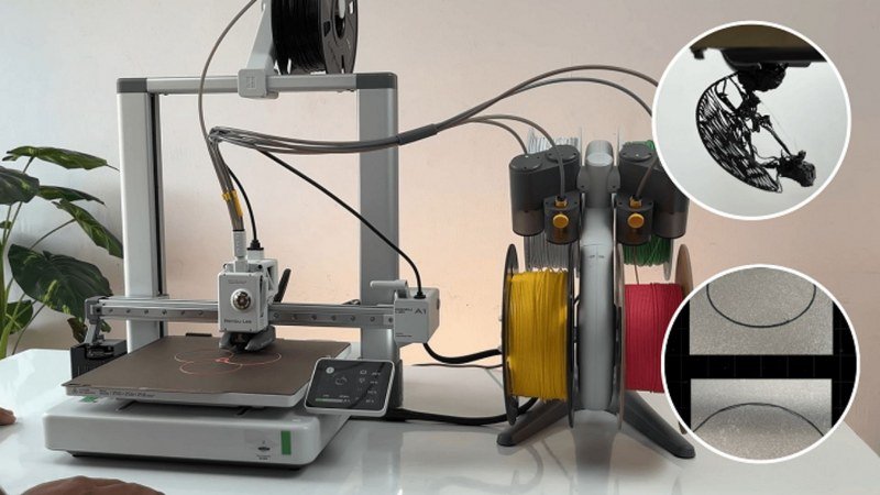

 36. Upgrade the 3D printer with 3D printer itself
One of the best parts of owning a 3D printer is… well, you can upgrade it using the printer itself. You can find them online easily for your printer.
For example, I upgraded this Bambu Lab A1 with a snap-on trash tray that catches the little filament poops the printer cuts off during filament changes or during the setup process. Super handy, especially with the AMS.
I also added a PTFE Y-splitter, which lets me use the external spool holder alongside the AMS Lite system, and a printable handle for the heatbed, which makes it way easier to remove when it’s hot.
